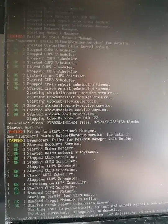

My system (Ubuntu 18.04.3) stuck on a black screen on this morning 11 september 2019. I just applied some normal update.. libsystemd0, systemd-sys, udev, some kernel update, ...
Failed to start Network Manager Dependency failed for Network Manager Wait Online
Black screen and stuck here. Unable to boot even in recovery mode! Tried also old kernel. Nothing work.
I read that other people have a similar problem.
Thanks in advance! Michael
