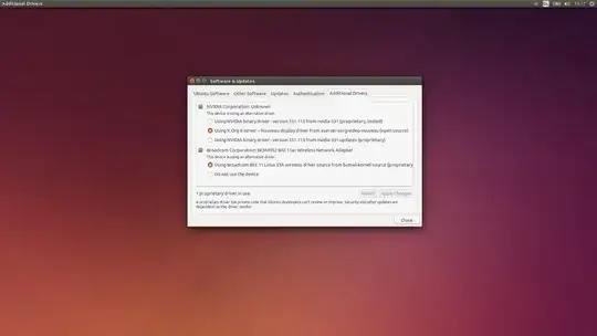

I probably need other drivers than I currently use. My current setting looks as follows:enter image description here.
I selected the "proprietary, tested" version once and it then says that I use the recommended driver. However, when I then booted again, I could still enter my password but after logging in, I could not do anything (ctrl+alt+T did not open a terminal, there was no bar on the left anymore). I could get back to the current status by following the instructions made by Marco Scannadinari. Now I am not sure how to get the appropriate drivers for my graphics card. I run:
