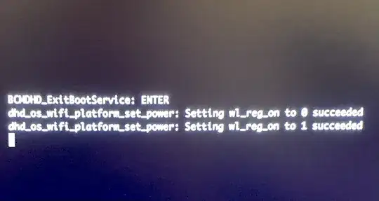

I get this before the grub bootloader initializes. Not exactly sure what any of this means, but the errors about not finding /boot or grub_platform are intriguing. Grub does indeed load and I pick Ubuntu, safe mode, etc...
Picking either Ubuntu or Ubuntu(safe) briefly brings this up:
I get several lines of apple-properties stuff and then some readout on device detection. It seems like some kind UEFI troubles here: enter image description here
The last thing it spits out is the rc-core line before shutting off, ie powering down. Not sure why this is the last thing to be reported, as the monitor has worked just fine with other Linux machines. This is as far as I can get. Any ideas? enter image description here

I’m not sure if this is true for all Apple T2 machines, or even all 2019 Mac Pro’s, but the boot parameter I need to pass was intel_iommu=on.
Now it’s on to getting grub to play nice...
