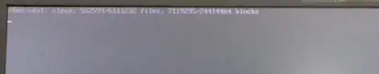

dev/sda1: clean, 552599/6111232 files, 7119295/24414464 blocks
After I turn on my laptop this message appears. The system never boots, the message just stays there.

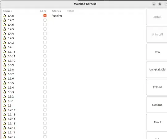

Hi for me the answer was totally different my issue was i was having a different kernel version so the grub was loading a different version of the kernel on changing the kernel to latest one fixed the issue to update the kernal i used mainline
sudo add-apt-repository ppa:cappelikan/ppa
sudo apt update
sudo apt install mainline
once kernel was installed i uninstalled the old kernel and switched to new one at the time it was 6.4.8 and when i checked after that the tool mainline updated the grub also to use the new kernal and the issue was fixed, this might not be the issue with all the case but this fixed for me if someone has the same issue you can also resolve this using this method enter image description here
