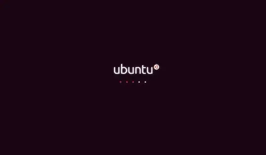

A black screen which appear after loading up the "Ubuntu" symbol. Then the screen prompted "No Input, entering sleeping mode". I wait for several minutes and no response. I reboot and got the same result.
Pressing the down arrow key show a flashing cursor on black screen.
The screen go black after this splash screen.
The screen goes black after this splash screen.
