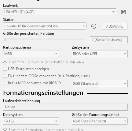

SYSLINUX Message appeared to me, too. Write client: Win7, ultra iso
Found solution: Rufus.
It told me about the missing files to write the ISO (which ultra didn't) - and downloaded them automatically. Now it works.
These are the specifications for Rufus:
