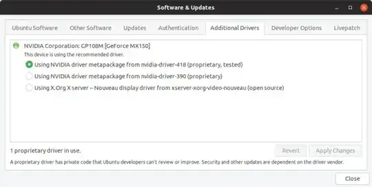

I am trying to install latest NVDIA graphics drivers on the ASUS zenbook 14, running Ubuntu 19.04. I am following this tutorial: https://www.cyberciti.biz/faq/ubuntu-linux-install-nvidia-driver-latest-proprietary-driver/
According to the window of the software updater, the driver is there:
But when I am checking the status of the driver, I get:

The driver is probably installed, but the Nvidia adapter isn't enabled.
Enable it by running:
sudo prime-select nvidia
Then log out and log in again. The adapter should now be enabled and nvidia-smi should work.
