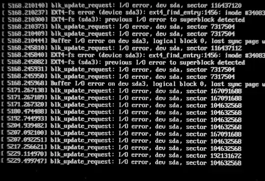

I have a Dell XPS (9360) running Ubuntu 16.04. About a year ago, it started black screening periodically and showing:
blk_update_request: I/O error, dev sda, sector 116437120
EXT4-fs error (device sda3): ext4_find_entry:1456: inode #340837
EXT4-fs error (sda3): previous I/O error to superblock detected
black screen boot messages
Often, I will be using Chrome and a page will fail to load, then the entire OS freezes,then I have to hold down the power button to get it to restart.

Ann
Your SSD may be failing... or just in need to some good (over due) maintenance.
First, we need to check your filesystem, as you have inode errors, and then some...
For 18.04 or newer...
  • boot to a Ubuntu Live DVD/USB
  • open a terminal window by pressing Ctrl+Alt+T
  • type sudo fdisk -l
  • identify the /dev/sdXX device name for your "Linux Filesystem"
  • type sudo fsck -f /dev/sdXX, replacing sdXX with the number you found earlier
    • sudo fsck -f /dev/sda3
  • repeat the fsck command if there were errors
  • type reboot
Update #1:
Go to https://www.memtest86.com/ and download/run their free memtest to test your memory. Get at least one complete pass of all the 4/4 tests to confirm good memory. This may take many hours to complete.
Update #2:
sudo dmidecode -s bios-version
Your BIOS should be version 2.13.0, released on 1/14/2020, as per https://www.dell.com/support/home/us/en/19/product-support/product/xps-13-9360-laptop/drivers
Update #3:
You need to update your SSD firmware. I think this will fix it.
LITEON CV3-8D128-11 SATA 128GB, S/N:TW0WVD60LOH006BP051C, WWN:5-002303-100c7f300, FW:T87110D, 128 GB
Go here to get the latest version...
Fixes & Enhancements
Fixes:
- Fix the system hang and disc detection issue due to FW bugs on certain corner cases
Enhancement:
- Improve the power consumption during idle state
Version
Version TCX110D, T8X110D
Category
Serial ATA
Release date
15 Jun 2017
Last Updated
03 Jan 2018
