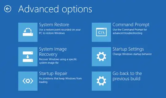

  1. Grab a Windows recovery or installation media and boot from it. You should see this or a similar screen on a recovery media.
System Recovery Options dialog

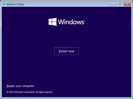

You should see this on an installation media. Click "Repair your computer" and you should see a screen like the first image.
Windows Setup

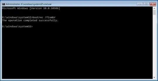

  1. Open the Command Prompt, then type bootrec /fixmbr into the Command Prompt.
Command prompt FIXMBR

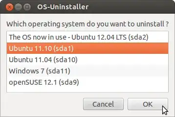

  1. Boot a live CD/DVD/USB with Ubuntu
  2. Choose "Try Ubuntu"
  3. Download and install OS-Uninstaller.
  4. Start the software and select what operating system you want to uninstall.
  5. Apply
  6. When all is over, reboot your computer, and voila, only Windows is on your computer or of course no OS!
