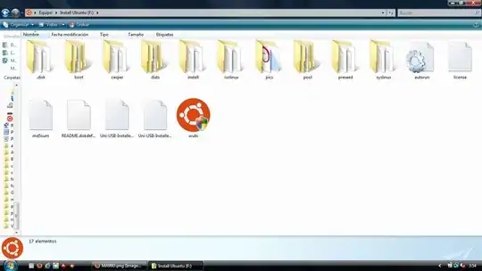

What I see inside the pendrive is this within a FAT32 filesystem:

I followed the instructions from https://help.ubuntu.com/community/HowToMD5SUM for Windows, installed winMD5Sum and made the comparison between the hashes on the md5sum file on the pendrive and the one that corresponds to ubuntu-12.04-desktop-i386.iso but they did not match. Any help please?

It seemed to be a problem with the usb port or the pendrive. I finally burned the iso image on a dvd and made the install from there without problems.

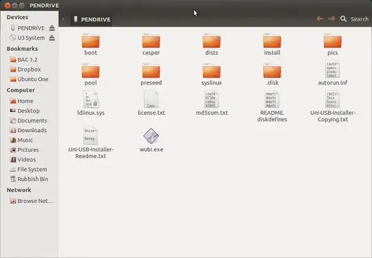

Where did you download your iso from? Normally you should get the same thing if you downloaded it straight off the Ubuntu site. Although your image seems to point out that you have the right files, although I have noticed you have some different ones to my USB installer, although I was installing from XP I don't think that should change much this is what I've got: enter image description here
I'm guessing you mounted it correctly but did you try mounting it with Pendrivelinux? For me that's what I've found has work best over the number of times I've had to install Ubuntu, never had an issue.
