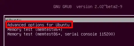

What you can try to do is to use Recovery Mode.
Choose it on GRUB screen by selecting Advanced options for Ubuntu.
ubuntu recovery mode
Then choose your kernel with (recovery mode) (should be second option)
On next screen choose Drop to root shell prompt
Log into root account. Then you can try to uninstall binary driver you've installed before or use dpkg-reconfigure to refresh its configuration.
