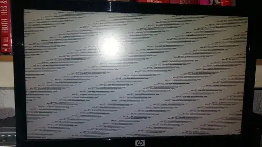

After an update, the Nvidia drivers wrecked my machine, I tried all fixes I could but couldn't get it to work until I purged Nvidia and selected Noveau. However, my computer freezes randomly the monitor only shows diagonal broken lines. I can only restart it by pushing the power button. Any way of fixing this would be much appreciated.
this is what happens
