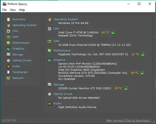

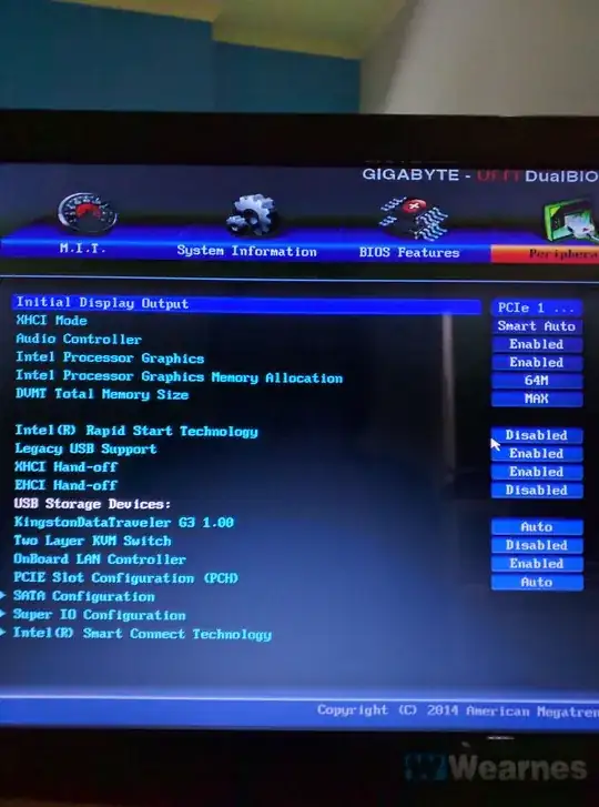

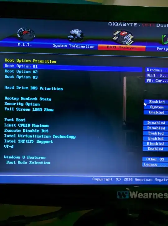

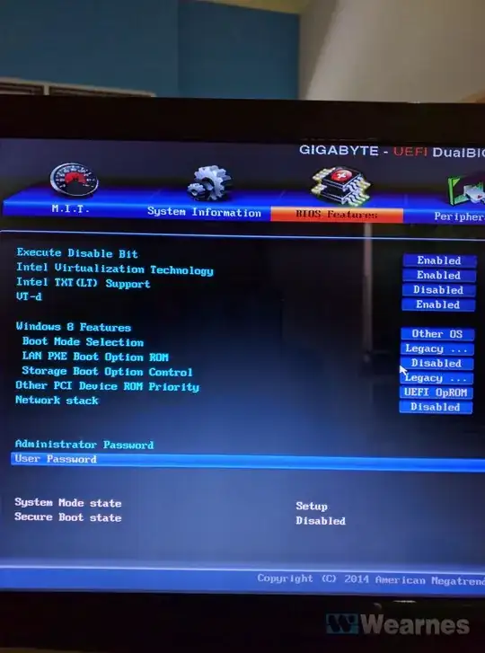

As a new member of this Ubuntu forum, I say greetings to you all! I cannot consider myself much of an advanced Linux guy, but I do prefer it over Windows in my work desktop PC. Which is very sad for me to find out that Ubuntu won't install or even run from live USB. Here's a few screenshots of my PC spec and BIOS settings:

  3. Tried with fast boot on and off. Same results.
  4. Tried with secure boot on and off. Same results.

At this point, I ran out of solution to make it work. I notice the official Gigabyte product page implying that Linux won't work with my motherboard, but I have had successes installing on my other PCs with similar warning. As of now, I have to live with Windows, which I hope will not be for long as I am optimistic about the prospect that Linux users like you guys will always make things work.
