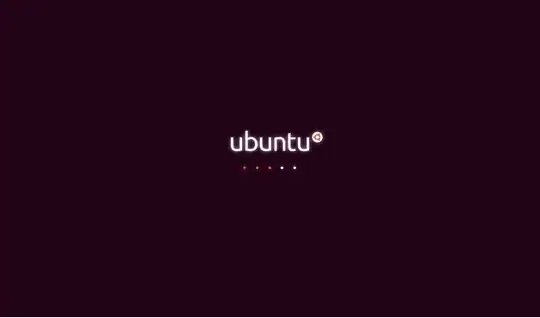

When trying to boot from the USB Key, it gives a terminal-like screen with four option,
Try Ubuntu, Install Ubuntu and some others options I don't remember.
When I select one of thoses two options, it tries to boot from the USB Key, at this point, it either freezes like that:
Or if I selected the Try Ubuntu option, I get a frozen desktop, but the mouse is free.
Or if I selected the Install Ubuntu option, I get a frozen desktop again but with the download Ubuntu dialog box, empty, there is just the language selection visible, oh and everything is frozen of course! But the mouse is free.
