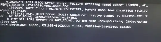

OS: Ubuntu 22.04 Desktop
GPU: Nvidia 3060
Recently I set my wallpaper and after pressing replace the OS crashed and would no longer boot. It now freezes on the screen in the screenshot.
I tried fsck and also updating the system, reinstalling my graphics drivers and updating the system, but it's still not booting to the OS.

Solved by booting into safe mode purging nvidia 515 drivers than installing nvidia 470 drivers
