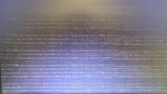

This question is not a duplicate of: My computer boots to a black screen, what options do I have to fix it? There is no purple screen nor black screen and the problem comes out while some loading text is printed.
The error happens before the GUI has loaded. It happens during the loading while some loading texts are shown.

Photo of the screen while freezing on loading text

This problem was a subset of two other problems, here is how I fixed it:
First of all I enabled the BIOS emulation in my UEFI setup, by doing this I could then boot (manually) the USB installer in BIOS mode instead of UEFI mode.
Then I fixed the problem with the GPU by changing the installer settings (up arrow-->choose language-->f6-->nomodeset, during the boot of the installator) and ran the installation.
