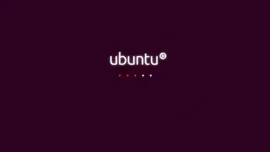

I upgraded my operating system from Ubuntu 12.10 to Ubuntu 13.04, and after the process of upgrading it via Software Updater, it requested me to restart the computer.
I rebooted and on boot it proceeded to a purple screen with Ubuntu text and 5 dots below it and continued to a blank black screen with a blinking underscore character (_).
I have all my files in there and I can't access them. I tried the grub boot menu edit that other questions pointed out, but it didn't seem to do anything.
