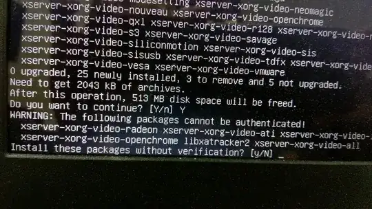

apt-get remove fglrx*

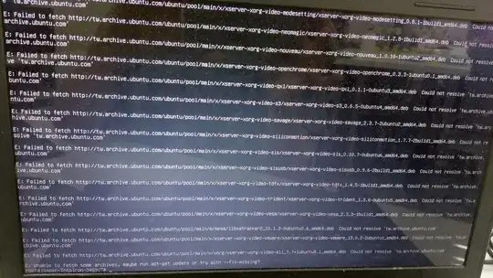

It looks like remove failed.
Does it mean that I need to "enable networking"? I've tried to choose that option in recovery mode, but it will show other error messages and can't open terminal successfully.
