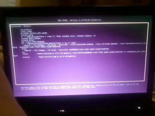

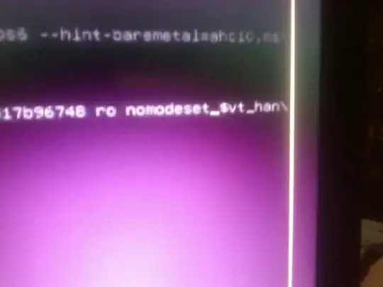

When following 2, this is what editing the Ubuntu boot option gives enter image description here enter image description here
Changing quiet splash to nomodeset allows me to boot (and even login) but the computer is incredibly laggy, graphics-wise. Like there's trails of black pixels left by the mouse cursor. While the other options like acpi=off or nolapic gets me to the login window, but freezes and reverts to the screen described at the start of this question. Everything is so laggy and prone to these stream of black pixels following my mouse cursor I can't even open a web browser and read stuff in it. See when I open a web browser, it opens but the blank pixels pop up when I scroll down in the browser. So I think the best option is for someone to work out how I might fix the problem that occurred with the changes recommended (in the answers) in the previous question I linked.
