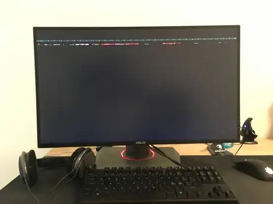

This system should run as a dual boot with Windows 10 which is installed in UEFI mode. I have also tried to install in legacy mode. I see the purple screen, then after several seconds there is a crash with other graphic errors. The graphical error in the picture below is when trying to install in UEFI mode.
Picture of screen as it freezes on install
picture of screen as it freezes on install

This problem was solved by running the start-up parameter nomodeset
Reference to these answers:
https://askubuntu.com/a/162076/852643
https://askubuntu.com/a/1024897/852643
