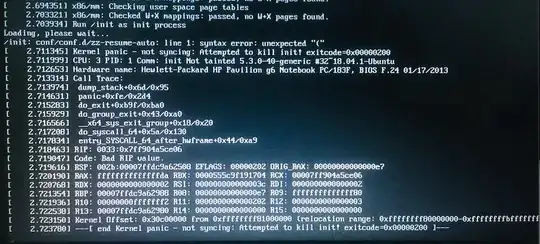

I have tried using grub to boot into the filesystem but with no success. I don't want to reinstall the OS using external media. Help me out to recover this issue. Do check the screenshot of the error in the below link image.
I am using Ubuntu 18.04 LTS as the only OS in my HP pavilion g6 with an intel i5 processor and 8GB ram.
Error Image
I have tried 'e' options before booting into the system and changing the Linux command line by removing 'quiet splash' with 'nomodeset'. I have followed most of the solutions but without success.

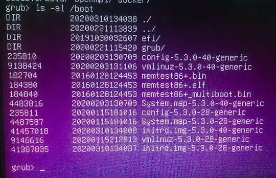

The output of ls -al /boot :-

A "kernel panic" occurs when the kernel for some reason cannot continue running.
"Attempted to kill init" actually means: "init died or failed to start." This is process #1 and it has a special place in Linux such that the system cannot run without it. Most likely there's a library error or some other problem which prevented the process from starting at all. Check the dmesg logs immediately before the failure occurred.
This error...
You've installed an application (like maybe zram, or some such) that has installed an invalid file zz-resume-auto.*, or you've manually added a file named zz-resume-auto.* somewhere that has an error in it, or you have a defective /boot/initrd.img-5.3.0-40-generic file.
Locate this file and correct the script error. Use locate -b zz-resume-auto or find / -name zz-resume-auto to help find this file. It might be in /etc/initramfs-tools/conf.d/. If so, you'll need to do a sudo update-initramfs -c -k 5.3.0-40-generic after fixing the script.

It's entirely feasible that you have a corrupted initramfs image for the kernel you are attempting to boot. Based on your ls -al /boot output this is either 5.3.0-28 or 5.3.0-40
The initramfs is a gzipped cpio archive. At boot time, the kernel unpacks that archive into RAM disk, mounts and uses it as initial root file system. All finding of the root device happens in this early userspace. These are typically found in /boot and on my system are called initrd.img-kernel-version
You can check to see if the file in question exists in the image by using the command lsinitramfs /boot/initrd.img-5.3.0-28-generic | grep zz-resume-auto (for example, adjust your filenames accordingly to the image your searching in and what you are searching for)
If this is the case, the The update-initramfs script will likely resolve the problem. Here's an excerpt from the [man page]
