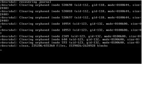

clearing orphaned inode and dev.. clean, blocks startup messages
When I tried to lauch Ubuntu on a virtual machine, nothing happens after this screen. I have installed the newest version of the Virtual machine.

Judging from the error message you might have shutdown the Ubuntu guest OS improperly by shutting down the virtual machine application without shutting down the Ubuntu guest OS first. This leaves semi-deleted orphaned inodes on the disk that aren't attached to a directory entry in the filesystem, which means they can't be reached. Since this could be a one-shot deal caused by an improper shutdown, booting the guest OS from an earlier snapshot would clear the error, if you have saved snapshots of the guest OS system state as you always should. If you didn't save any snapshots you have nothing to restore the operating system back to in case of a serious system error.
Without any snapshots you would have to access the virtual console with the keyboard shortcut Ctrl+Alt+F3 (or any of the F3-F6 keys) and boot from there.
The last resort is to reinstall the guest OS since it's a new guest OS anyway and immediately save a snapshot after the first reboot.
