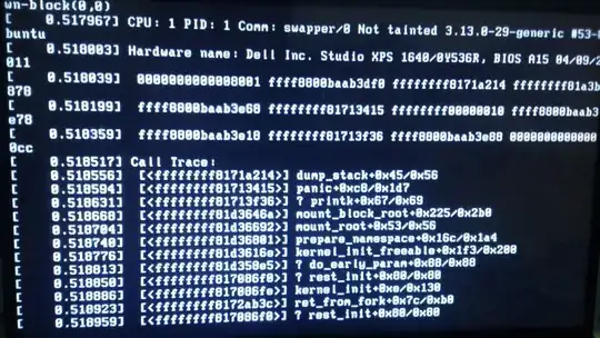

I installed Ubuntu 14.04 without any problems and then I gave the system update option. After all the packages were downloaded and stuff, I was asked to restart the system, but after that, it is not opening. I get a black screen with call traces after I choose Ubuntu in the grub.
Any help would be appreciated!
This is the error message:
http://i.imgur.com/cDGxB72.jpg

Looks like a kernel bug to me. Try selecting an older kernel in the GRUB menu. (If the menu doesn't show up automatically, press the shift key while booting.)
If this works, then you've found a kernel bug. You should consider reporting it. Hopefully it will be fixed in a future update.
