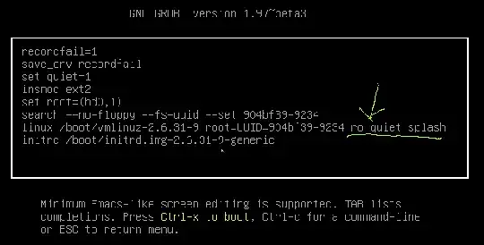

Here you go:
Are you on Nvidia Graphics card? If yes, then start in nomodeset instead of quiet and install nvidia graphics driver using terminal and restart, voila.
Permanent Solution : Start your system in nomodeset, after the system is up and running open terminal and add the graphics driver repo using 'sudo add-apt-repository ppa:graphics-drivers' then update using 'sudo apt-get update' then finally install the latest nvidia drivers using the command 'sudo apt install nvidia-384', after the installation is done, reboot your pc and you won't longer need to change it to nomodeset everytime you boot up, also you can install nouveau drivers instead nvidia, which are opensource and may be more stable than the nvidia one, if you don't do any extreme gaming on your Ubuntu then I'd suggest you to install the nouveau drivers.
