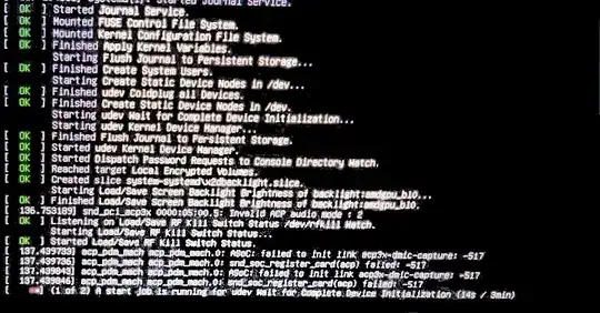

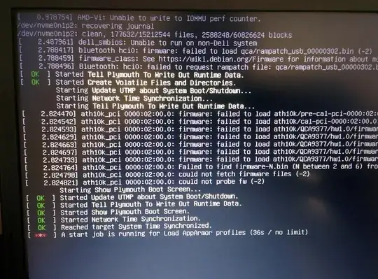

Acer splash screen when it's stuck:

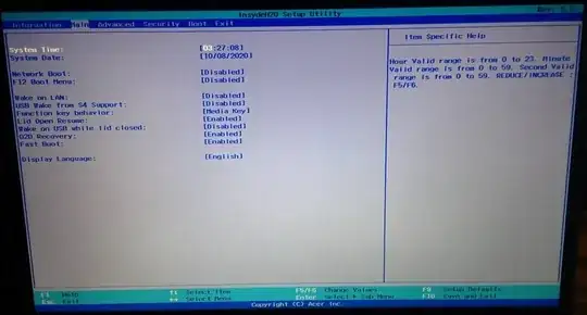

I disabled all possible items in the BIOS, tried different ISO images, but all to no avail. The Ubuntu installation comes to boot and freezes on the Acer splash screen. I think that the problem is in the drivers that are not in the Ubuntu kernel for my hardware.

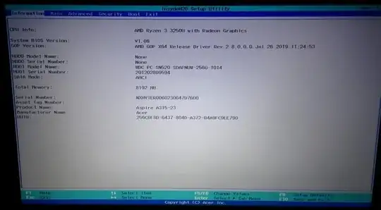

BIOS:
enter image description here enter image description here enter image description here enter image description here enter image description here enter image description here

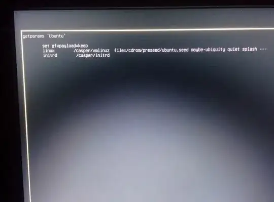

Boot screen:
my Linux boot
Boot without splash gets stuck too:

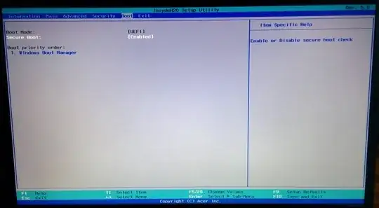

Also my BIOS does not support Legacy, the item with the boot mode selection is inactive:

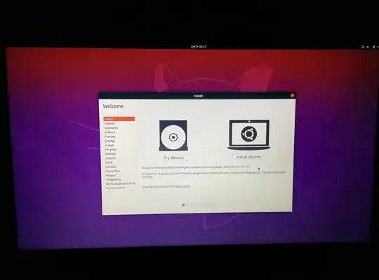

Ok guys, I have good news (or not). I just decided to boot with the ssd drive of my laptop disabled, namely in the Advanced tab in the BIOS, in the Storage Device Configuration I disabled HDD1 and Live USB Ubuntu booted without problems, I checked all the functions and absolutely all the sound works, adjusting the brightness of the screen keyboard touchpad and etc. no errors, everything is in order with the drivers. It turns out it's only about my SSD, but when it is disabled in the BIOS, I certainly cannot install anything and this is a problem that I did not solve.

In some laptops I found problems booting with USB 3, and I had to use USB 2.0. In some others, I had problems booting with all USB sticks but I had not problems booting from a USB DVD player/recorder, so that's the last resource, to toast one DVD with the ISO and boot from an external USB DVD drive.
Also the last line of your screenshot said that the job have been running for 14 seconds of a max of 3 minutes. Can you provide a screenshot of the final outcome, after having waited at least 5 minutes?.

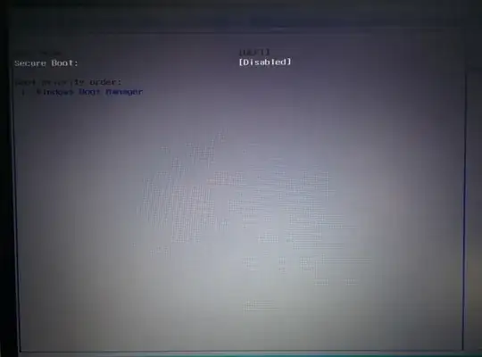

I noticed on your security screen that "Secure Boot" was still enabled, although you said you disabled it. Some BIOS have a constraint that "Secure Boot" cannot be disabled unless the supervisor password is set.
Therefore, you could try setting the supervisor password and then disable secure boot. If it still doesn't work, check that the secure boot is still disabled. If it isn't disabled, try "Erase all secure boot setting" and disable secure boot again. (You can always reset the default secure boot settings, so the action shouldn't be irrevocable.)
