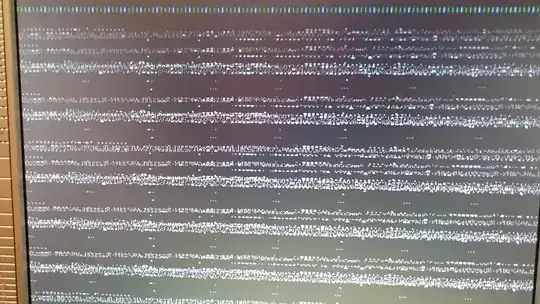

However instead of the installation beginning the screen goes blank for a few seconds and then some gibberish appears and scrolls through the screen (like it would during something like apt get upgrade) for a few seconds then freezes.
gibberish on screen

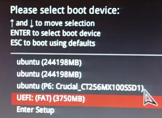

everytime I've retried the whole process it added ubuntu(244198MB) to my boot list (after some time I had it in there 15 times, although the only present things should be the P6 and UEFI line - my SSD and the USB stick).
boot list

Alright I've solved the problem after looking at the link provided by MichaelBay. Apparently it was some kind of driver issue caused by my graphics card. Here's what I did:
  1. plug in the USB stick, select UEFI boot option in boot order of motherboard, boot into grub menu
  2. press e to edit boot settings, change quiet splash to nomodeset, boot with F10
  3. follow Ubuntu installer
  4. reboot, at reboot repeatedly press Shift to get into the grub menu, hover over 'Ubuntu' and again press e and change quiet splash to nomodeset and boot with F10
  5. in Ubuntu use sudo apt update and sudo apt upgrade
  6. repeat 4.
  7. launch 'Software & Updates' program, switch to tab 'Additional Drivers' and switch to the proprietary driver by NVIDIA
  8. reboot regularly
Now I can use my system normally.
