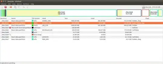

I have a dual boot laptop system that has been running windows and Ubuntu 14 LTS. I just had my Motherboard, LCD screen, and LCD cable replaced on my laptop and now I can't get Ubuntu to load. Grub loads just fine but when I select Ubuntu I get the Ubuntu logo boot screen. Then I get a black screen that never goes anywhere. But I can select Windows and have it boot properly. After reading about fixes and trying them it seems I am left with trying to reinstall or upgrade using a Ubuntu live usb. When I attempt to upgrade I get an error message:
"The partition table format in use on your disks normally requires you to create a separate partition for boot loader code. This partition should be marked for use as an "EFI boot partition" and should be at least 35 MB in size. Note that this is not the same as a partition mounted on /boot. If you do not go back to the partitioning menu and correct this error, boot loader installation may fail later, although it may still be possible to install the boot loader to a partition."
I am not sure how to fix this problem. I have included a screen shot of both Gparted and the Installation type page. If any more information is needed to solve this problem please let me know. Thank you.
gparted
installation
