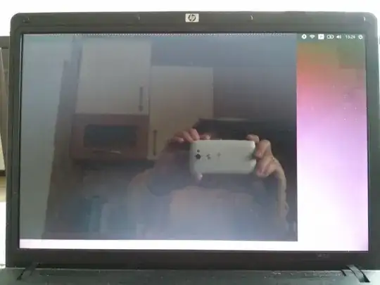

A black window covers almost the entire desktop.
It looks like a broken terminal window.
I thought that the cause might be Intel proprietary drivers so I removed it, but that did not help.
Also, I noticed that the system boots without logo Ubuntu.
When I choose a particular kernel in GRUB (4.2.0-19), everything work fine, the problem does not occur.
When I start with the default kernel (4.2.0-35) I have this black window on my desktop.
I added a camera picture because when I made the screenshot, the black windows cannot be seen as if it were not there at all.
My computer is HP 530 IntelĀ® 945GM x86/MMX/SSE2.
I will add that I am new to Linux.
Black window covers almost the entire desktop

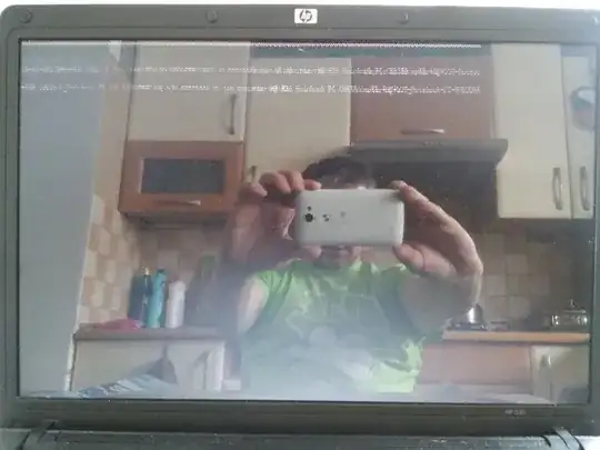

When I switch tty, the black window fills the screen and is damaged, the font is unreadable.
scrambled lines of text on black screen
