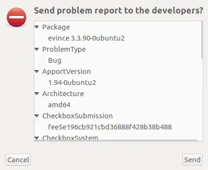

After executing any of the above commands, Apport (Ubuntu bug-reporter) will collect necessary data. A window will then pop up, asking you if you want to report the bug. Click "Send Report" if you wish to proceed, or click "Content of the report" if you want to review the information Apport collected.
apport-problem-report
Apport will then upload the problem information to Launchpad, and a new browser window will then open to inform you that the bug report is being processed. After the bug report data has been processed, a new page will open that will ask you for the bug report's title. The bug title will appear in all bug listings so make sure it represents the bug well. When you're done, click "Next". A search will then occur based on the title you gave to the bug report, and will show potentially similar ones. If one of these seems to be the exact bug you're reporting, click its title, then "Yes, this is the bug I'm trying to report". If not, click "No, I need to report a new bug". Launchpad will then ask you for further information. It's important that you specify three things:
