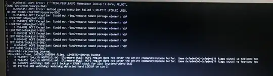

Then at the second attempt, something completely different happened. Ubuntu did not started. But it gave some errors about ACPI as you can see in the picture:
Screen pic after grub
But I found a way to start Ubuntu. I select resume boot option at the recovery mode from grub. And it starts and works.
