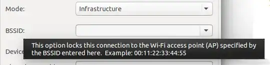

In the case where either the blacklist.conf or apt-get re-install for b43 Broadcom didn't work, it may simply be because the default wireless config still hasn't been enabled properly for WPA/WPA2.
Network folder, wireless and select Options ubuntu 12.04:
  • ipv6 tab - just keep the method as automatic and uncheck the 'Require IPv6 addressing...'
  • ipv4 tab - method should be automatic (DHCP) and check the 'Require IPv4 addressing...'
  • wireless tab - force device mac address to lock connection to the permanent mac address of the laptop
