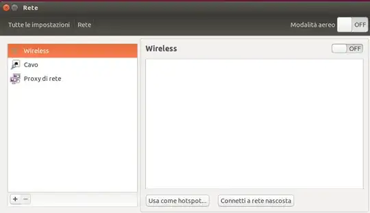

I'm using Ubuntu 15.10 but I'm unable to access Internet wireless.
The output for rfkill list all is given below:
0: phy0: Wireless LAN
    Soft blocked: no
    Hard blocked: no
1: brcmwl-0: Wireless LAN
    Soft blocked: no
    Hard blocked: no
2: hp-wifi: Wireless LAN
    Soft blocked: no
    Hard blocked: yes
3: hp-bluetooth: Bluetooth
    Soft blocked: no
    Hard blocked: yes
The output for sudo lshw -C network is:
  *-network
       description: Ethernet interface
       product: RTL8101/2/6E PCI Express Fast/Gigabit Ethernet controller
       vendor: Realtek Semiconductor Co., Ltd.
       physical id: 0
       bus info: pci@0000:02:00.0
       logical name: enp2s0
       version: 02
       serial: 90:fb:a6:a7:1c:47
       capacity: 100Mbit/s
       width: 64 bits
       clock: 33MHz
       capabilities: pm msi pciexpress msix vpd bus_master cap_list rom ethernet physical tp mii 10bt 10bt-fd 100bt 100bt-fd autonegotiation
       configuration: autonegotiation=on broadcast=yes driver=r8169 driverversion=2.3LK-NAPI duplex=full ip=192.168.0.106 latency=0 link=yes multicast=yes port=MII speed=100Mbit/s
       resources: irq:25 ioport:2000(size=256) memory:c0410000-c0410fff memory:c0400000-c040ffff memory:c3400000-c341ffff
  *-network DISABLED
       description: Wireless interface
       product: BCM4313 802.11bgn Wireless Network Adapter
       vendor: Broadcom Corporation
       physical id: 0
       bus info: pci@0000:03:00.0
       logical name: wlp3s0
       version: 01
       serial: 00:26:82:a0:2f:10
       width: 64 bits
       clock: 33MHz
       capabilities: pm msi pciexpress bus_master cap_list ethernet physical wireless
       configuration: broadcast=yes driver=wl0 driverversion=6.30.223.248 (r487574) latency=0 multicast=yes wireless=IEEE 802.11abg
       resources: irq:18 memory:c2400000-c2403fff
When I try to active my wifi i can't... enter image description here
I also tried with sudo rfkill unblock all but it still isn't working
Router: Sitecom
My laptop is a HP-G62.
Dank13
Your WiFi is disabled in hardware: on Page 2-4 of the manual of your computer: press the Fn+F12 to turn the WiFi on or off. If that fails, maybe the BIOS setting is set to not use the Fn key. In that case: press F12 all on its own.
