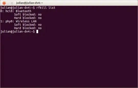

First of all: I'm in a HP Pavilion dv4-1528la, running Ubuntu 12.04 LTS
Well, I must say within last 4 hours I've been trying every possible solution I found in any ubuntu forum. And I finally made it, found the solution shared in a spanish forum. I hope is not too late to help someone to find its way.
So, after trying any possible combination with rfkill in terminal, with and w/o sudo, trying to delete some config files I've found in other "possible answers", and searching into BIOS setup the option I didn't find about turning on Wireless always on startup, I kept digging and the answer I found was this:
Due to an error in linux kernel, rfkill sometimes doesn't act as expected, and there is some incompatibility within linux hardware controller and some hardware devices. Solution recommended by this guy is to start laptop with a bootable pendrive and start wireless from there.
So that's what I did, fortunately I had the pendrive wich I used to install current Ubuntu 12.04 LTS OS I'm in now, and after booting with it, I was able to start wireless directly from the menu bar icon. Then it's just a matter of turning off, remove pendrive, and turn on again from HDD. And it's working again, no hard-block anymore.
Pd: I'm just guessing, but I think what triggered the issue in first place is that I turned off the laptop with Wireless deactivated, and then after turning it on again, there was no way to unblock wifi hardware from being off, or not at least with my touch hardware switch.
