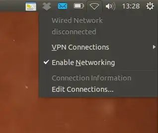

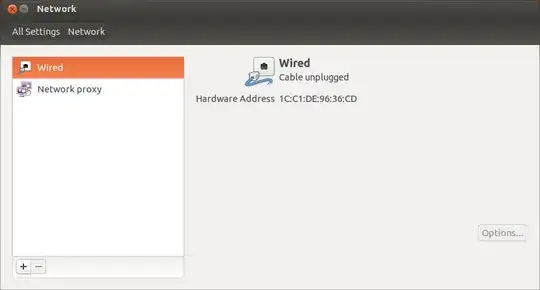

On my friend's Ubuntu 12.10 (Unity) laptop, there is no longer an option to connect to a wireless network. It used to work. He doesn't know what caused it to go away, but does anyone know how to get it back?
More info:
  • See the screenshots below
  • No wlan things show up when you run iwconfig
  • Laptop is HP ProBook 6550b
enter image description here Network Settings

Your laptop model appears to have a Broadcom wireless chipset.
open terminal and type what is shown below
sudo apt-get purge broadcom-sta-common broadcom-sta-source bcmwl-kernel-source
then type
sudo apt-get install b43-fwcutter firmware-b43-installer
Restart your computer after the command is completed and your wireless will start to work :D
