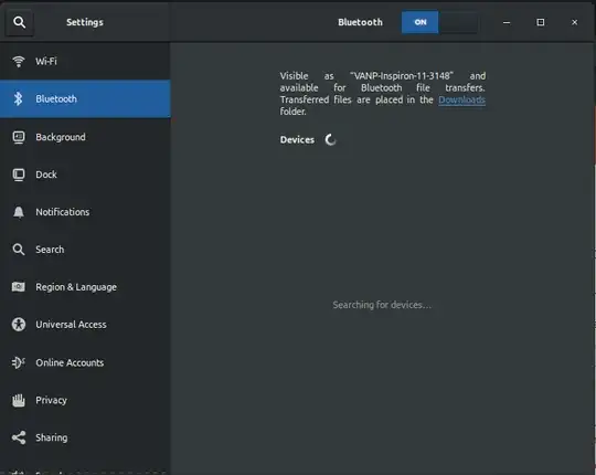

The Bluetooth window is fixed as shown in this screenshot and never changes:
