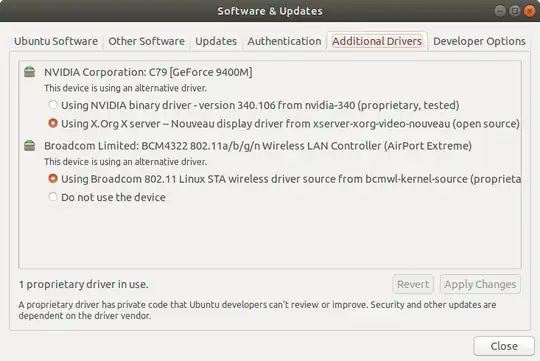

If you open "Software & Updates" and go to the "Additional Drivers" tab, what do you see? It should look similar to my screenshot.
Make sure "Using Broadcom 802.11 ..." is selected, probably it says "Do not use this device". Once you click the other radio button and then hit apply, it should download and install the driver.
