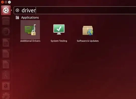

You might need to install the proprietary driver for your Broadcom wireless card.
Please press the super key (the windows key) to open your dash, and search "driver" for it: Search driver in dash

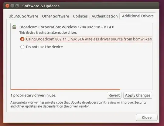

And open the "Additional Drivers", select the driver and click "Apply changes":
Additional driver
