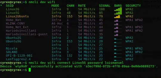

Part 3: Easy Connection via nmcli
Although we have talked about the ways to connect to it without a network manager, there is also the case of using nmcli (CLI version of the network manager) when it applies. To do this, we do the following:
  1. Check to see which ESSID we can see:
    nmcli dev wifi
  2. Verify the name of the ESSID and we proceed on using it on the next line including the password needed for it (This includes WEP and WPA type passwords):
    nmcli dev wifi connect ESSID_NAME password ESSID_PASSWORD
    Here is an example of me connecting to the ESSID Linux5G
    screenshot
    If you have multiple wireless devices on your computer, you can specify which one to use using the ifname parameter like so:
    nmcli dev wifi connect ESSID_NAME password ESSID_PASSWORD ifname WIRELESS_DEVICE_NAME
    For example in my case the name of the device is wlp9s0 so I would use this line to specify the device that I will use to connect with:
    screenshot

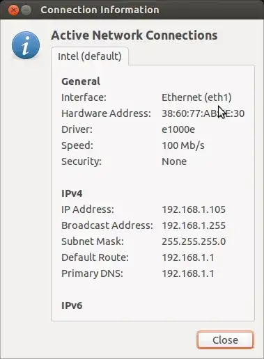

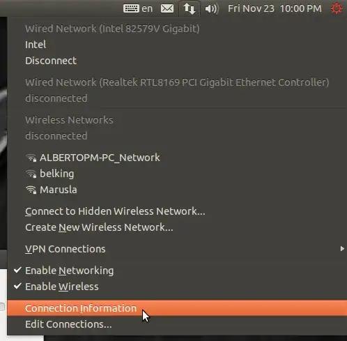

Bonus: Find your wireless connection's name GUI Style
  1. Click on the Network Manager and go to Connection Information
    screenshot
  2. Go to the Tab that holds your wireless card
    screenshot
In this image, this network card is named eth1 (Inside the parenthesis) but this can be different for each user. Normally it would be a wlan (Like wlan0, wlan1, wlan2...) but it can also be eth1, eth2, etc.. So you need to see what name it has.
Another way to find the name quickly is by typing iwconfig which will show all the wireless network card available.

It's pretty easy if you know how to do it.
Show available wlan access points:
nmcli dev wifi
Connect with access point:
nmcli dev wifi connect $ACCESS_POINT password $PASSWORD

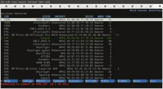

I use wicd-curses, which I find to be the easiest user interface by far.
wicd-curses
You need to use the (right arrow key ->) to set configurations; everything else is obvious from the on-screen instructions.
Of course you need to find some way of getting on the internet without wicd; I'm assuming you have already solved that or else you wouldn't be posting.
