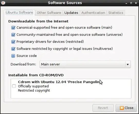

Well, you have to have an internet connection somehow. Then you need to add the software source(repositories) needed for the b43. Make sure that they look like the image below. Make sure that you have a check mark just like the image.
Then To install the firmware,
Just press Ctrl+Alt+T on your keyboard to open Terminal. When it opens, run the command below.
sudo apt-get install firmware-b43-installer
Another way is to open Synaptic and go to Settings > Repositories and enable as shown in the image above, and then search for b43 and install your packages.
All that of course after adding the software source(repositories)
