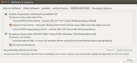

I am trying to connect my 9 years old Dell XPS M1530 to Wifi. In the "Additional Drivers" tab, I got the following: enter image description here
I select the first option under "Broadcom Corporartion" but when I hit "Apply Changes" it instantly goes back to "Do not use the device". This is also happened in "Try Ubuntu" when I tried to test the Wifi connection prior to installation from bootable USB installation drive.

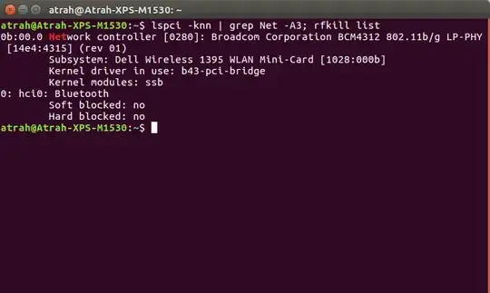

Running the following command: lspci -knn | grep Net -A3; rfkill list
I got the following output: enter image description here
