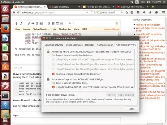

As mentioned in this video
and here the screenshot of driver for Wifi

The BCM43227 apparently needs the STA driver, which can be loaded with
sudo apt-get update
sudo apt-get install --reinstall bcmwl-kernel-source
sudo modprobe -r b43 ssb wl brcmfmac brcmsmac bcma
sudo modprobe wl
The source for this set of commands is at this location
