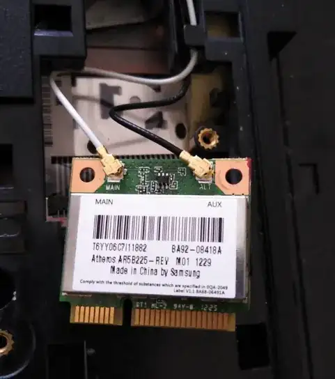

Your readings strongly suggest that one or both of the antenna wires are not firmly snapped in place on your wireless card.
At a distance of two meters or less, I'd expect a signal strength of Quality=70/70. I recommend that a qualified technician examine and repair your computer.
