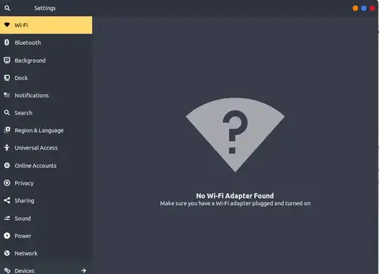

Ok so I rebooted my computer, and something is different... My Wifi connect panel is gone! Seems like I do not have a wifi adaptar anymore!
Weird thing is that using lshw does detect the adaptar...

What is going on?!
