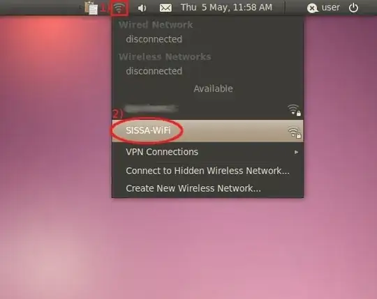

If it works, then you should see the desktop's GUI wifi icon in the panel / menu bar and see & connect to wireless networks, similar to this:
Wifi icon menu

Towards the top right side of your screen, there should be a weird cog looking thing, the time, a speaker icon, battery, and last should be two arrows pointing up and down in opposite directions. Click on the arrows and it should give you an option of network connection options.
If this does not work, try navigation to the top left and left click Activities. In the search bar, type in Network and select Network. There should be more options for networks and connection types.
