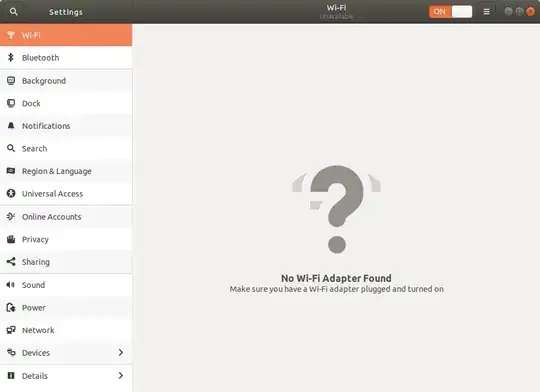

Thank you all very much for your prompt response. I apologize I have not been equally prompt. I tried Fn+F3, yes, when I first bought this laptop, I think it was Ubuntu 12.04 in those days, that was an issue, but not since. I just tried it tonight & it toggles to the airplane mode. Fn+F3 again goes to non-airplane mode.
As you can see from output below, hard blocked is yes even though I did an unblock all. I've also done a screen shot of wifi settings below. Hope it comes out okay.
$ sudo rfkill unblock all
$ sudo rfkill list all
0: acer-wireless: Wireless LAN
    Soft blocked: no
    Hard blocked: no
1: acer-bluetooth: Bluetooth
    Soft blocked: no
    Hard blocked: no
2: phy0: Wireless LAN
    Soft blocked: no
    Hard blocked: no
3: brcmwl-0: Wireless LAN
    Soft blocked: no
    Hard blocked: yes
5: hci0: Bluetooth
    Soft blocked: no
    Hard blocked: no
Wifi Setting

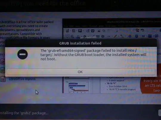

thanks 4 the prompt response leonard & pilot6. I was thinking back at my installation since it was a long time ago, decided to reinstall, this time w/o the "install proprietary drivers" check box. It worked in the past, but this time not. Also, as I said, this system actually does not support UEFI, so there might not be any such thing as BIOS defaults; however, if I do not install as UEFI, boom! get this err message in the middle of installation.
So I installed with a UEFI partition & the installation goes through, but system does not detect wifi. I tried installing Kubuntu 18.04 on a different partition, same problem.
