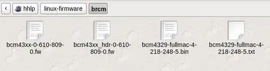

"Download and copy the device's firmware", i have the solution for that :
  • We also need to install the firmware files in the proper directory. These can be found in the other repository (linux-firmware). (More information can be found in the linux-next/drivers/staging/brcm80211/README file.)
when you execute these 2 commands :
git clone git://git.kernel.org/pub/scm/linux/kernel/git/next/linux-next.git
git clone git://git.kernel.org/pub/scm/linux/kernel/git/dwmw2/linux-firmware.git
it created two folders in your home directory :
1.- linux-firmware
2.- linux-next
these files are located in :
cd ~/linux-firmware/bcrm
