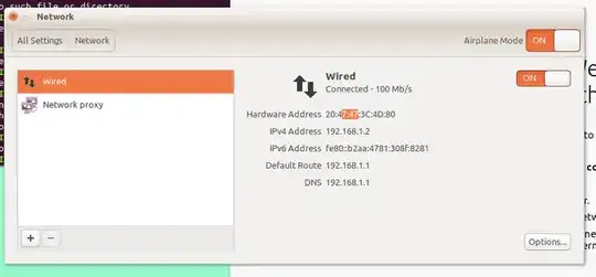

After rebooting (as prompted to do once the script was executed), the wired connection sign disappeared from the taskbar as well. I opened the system settings/network connections and got this:
It seems I do have a connection but still no working internet connection!!!
