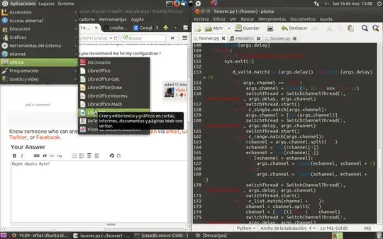

Ubuntu 11.04 has reached End of Support in 2012. I recommend Ubuntu MATE 14.04 for this laptop. It will run in a extremely fluent way. Here you're a screenshot:
Ubuntu MATE Screenshot
