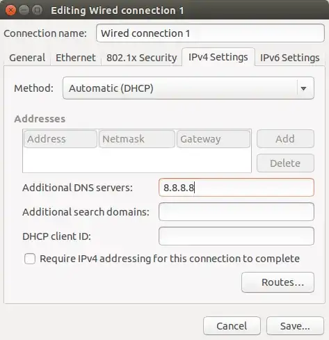

You may also wish to check your DNS settings and compare to your ISP's recommendations. Or add Googles public DNS at 8.8.8.8 as shown here if you have a GUI:
DNS
Or via the CLI by editing /etc/network/interfaces as answered here
