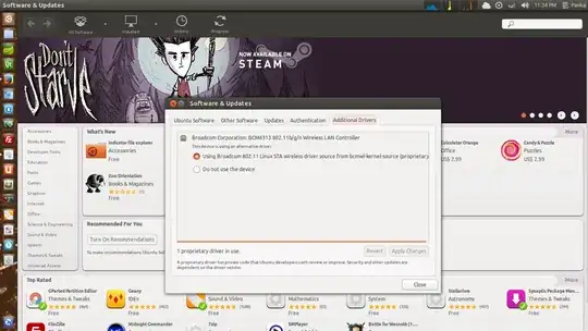

Also open Ubuntu-Software-Center and go to edit-Software Sources - Addition Drivers and check the Wifi Driver in my case as shown below -
And also one of the most important thing Open BIOS and check wifi is enabled or not.
